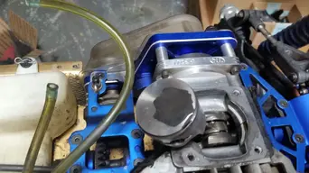

20180420_214819.webpThat's 18 months of carbon using Maxima Castor 927 at 25:1. There is very minimal cylinder wall and piston skirt wear. The carbon deposit doesn't even seem too bad to me. I've seen guys piston tops have 3mm of carbon the whole way across. That engine is a Zenoah g320 in a Rampage MT

yes, thats the oil i use. and yes g-man - if you run too rich with 927 its a mess.-- 3mm carbon would destroy most of my engines. I run high compression - use 110 octane.-- my squish clearance is 0.020". no room for any carbon build up.
