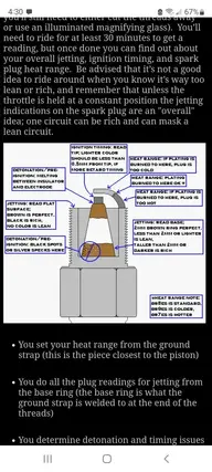

can someone put together an updated 2 stroke plug chart? The sticky link does not work and finding accurate info is like pulling teeth
