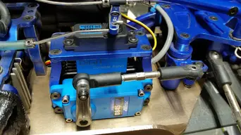

okay I ran into a problem with the single Servo saver, the brass looking inner tube on the stock setup is not on the single unit so theres play? Im at a standstill cannot figure this out. Im speaking of the long piece that you bolt at each end to the upper brace, wihout that brass tube in the middle theres play?

The brass tubes aren't tubes. They are small rings set down into the servo saver. Pop those out and put them in the new saver. Or you can measure and buy flanged bearings for in there. I still use the brass bushings, never had the motivation to buy flanged bearings for it.

Yes right after i put this post i figured it out, i didnt know how to close the thread, btw i got the single servo assembly installed along with the futaba mount d845 and hitec 5645mg, later ill get it all bolted up. Only thing i see is the steering link hits the diff case when turning right, it turns alot less to the right than it does to the left, besides shaving the plastic link down how else can this be fixed?

You have to set the steering end points for the servo so the inner links don't hit the diff housing. First though. Zero out the steering trim and install the servo horn as vertice as possible then center your steering rack assembly with the link from the servo horn to the servo saver. Then set the servo travel end points on the radio.

Regardless of the endpoints the right turn steering hits the diff case at about 50% unlike the left turn he link hits he diff alot later making the steering less to the right
