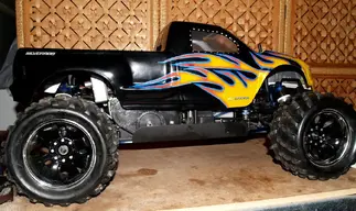

Yes it is caused because they don't have bump stops on the steering and the wheels turn to far and pops the drive shaft out especialy when they hit something at full lock. You can get upgrade uni drive shafts for them to fix the problem or you can fit a steering stop by fitting a 5 or 6mm bolt in the bottom control arm and fit a bit of fuel tubing over it to limit the steering lock
Hi Mate,
you mentioned upgrade drive shafts for the titan, where could I get some of those, I have the same problem.
I'm also after any hop ups available if you have any pointers I would appreciate it.
