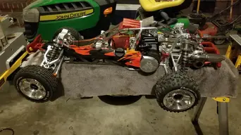

However, on my other Baja that is not a Rovan or King Motor, I use this one:
https://www.detroitperformancerc.com/product-page/rcmax-zenoah-cy-billet-easy-start
It will not fit under the body panels unless you modify them. I recommend the outerwears cover specifically for the Taylor RC pull start. It keeps the dust out. I have it mounted on a Taylor 35cc engine. Before I used that engine, also used it with a Zenoah-ESP G340RC engine. As I found with the Rovan design, a similar issue can happen with this one, the spring loaded levers may get stuck in the run position due to dust collection. Having the outerwears screen to keep the fine dust out works. You will need the underside engine cover as well. Grass is not the issue, the fine dust and sand tends to cause issues.
