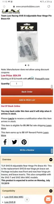

51896these are the rear hing pin braces and the little black insets change toe and anti squat
if you change the anti squat in the rear to 3 degrees it will raise the back suspension(y)
i just change mine from 2 to 3 and it makes a big difference (y)

Unfortunately the 2.0 isn’t like the B.. 😔... for it you have to change the whole toe plate
At some point I’m gonna upgrade mine to the 5ive B setup... much better I think
Cupton79
265
What do you mean? What do you consider the whole toe plate?
The kit says it fits the 2.0
The kit does bolt right on the 2.0... but... For the 2.0 the toe plates aren’t adjustable themselves
If you remove the 2 bolts that hold them on and you remove the outer plastic piece you’ll see the toe plate which will be marked what degree it is... to change it you must buy a different set.. DDM sells em in different degrees..
The 5ive B comes with adjustable toe plates... as the pic Doug uploaded shows has different inserts to change toes settings... a much better setup IMO
thats a pic of the 5t [email protected]Cupton79 is right cant change it with out buying in the tlr part😞

Got it guys. The current set up does not allow for inserts. I would have to buy the tlr kit which would allow for the inserts. That's what I understood. I wonder why they didnt include that kit in the stock config? Haha
