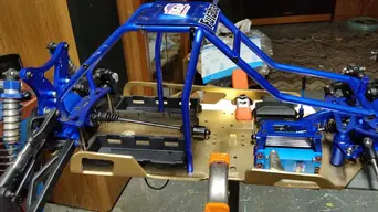

I am in the process of redesigning this broken cage to suite my brushless project. Moving the two uprights forward for battery tray clearance. Going to braise them on with those aluminum braising rods Harbor Freight sells. Have to strip the blue off first.20180910_232032.webp

I am going to use a self igniting Mapp gas torch. I do have oxy/acetylene torches too. I think the Mapp will have the correct temp needed to do it.
