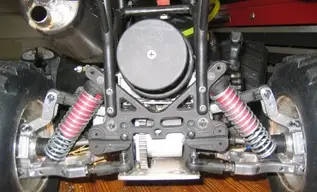

You will notice in the last photo the person fitted the FG alloy uprights to take out some of the flex on the rear end. Since this is not the MT you will have less flex from the smaller tires, but the only real way to remove completely the flex is to upgrade the rear lower arms to alloy and you could also install the risers to move the upright rod higher away from the gears. Here is a photo of the rear of an FGMB/FG buggy with this setup I am not sure if the risers work with a 2 speed though? You should be ok with the buggy though it is a bigger problem with the FGMT and the bigger tires.
Here is the rear arm flex I'm talking about, gets worse the older the arms get on the MT. You will see the flex toward the gear allowed by the plastic lower arms.
http://media.putfile.com/Rear-arm-flex
