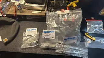

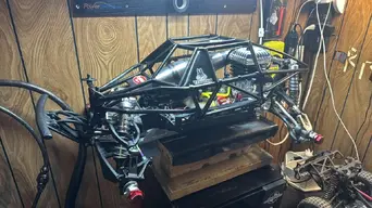

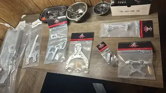

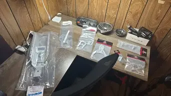

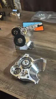

hey guys, I just recently over winter did a baja scratch build and im running a Taylor 46gt in it, this is a first for me as all I have run are the smaller zenoah engines, and I have some questions.
Can I run 93 octane for fuel? Can I use amsoil synthetic for oil? What ratio should I be mixing my fuel and oil? I did look on Detroit and did not find much for fuel/oil ratio, but I ran 25:1 in my small bore engine.
Any help I can get is greatly appreciated, thanks
Done so far:
IRC chassis
Taylor hd engine plate
Taylor trans
Black one gears
Taylor lay shaft
Kraken wide kit
IRC hd extended shafts
Taylor front shock tower
Taylor front and rear upper plate
Taylor rear tower brace
Taylor rear hubs
Team chase upright supports
IRC rear shocks
RPM rear bumper
Phatdad rear hinge pin brace 2°
Kraken hinge pins
Kraken x2e arms
IRC shocks front
GH racing front steering casters aluminum
Vertigo hub extenders
Outlaw wheels
Hostile MXT tires
Team chase cage
Protek t100 throttle servo
Hitec steering servo for now..
Ddm 7.4 lipo rx pack

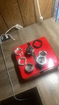

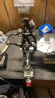

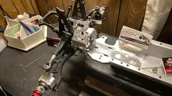

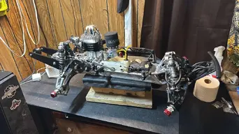

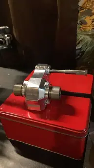

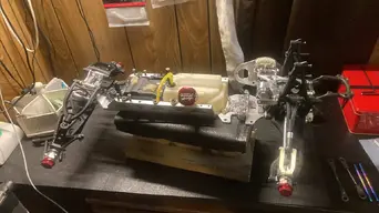

some pics of my build. thanks for looking

So I managed to get the big bore out today for its first start! I was going to order the stuff Mike Taylor recommended, Well I decided to go with 93 octane pre mixed with amsoil syntheyic. She started so easy for the first time. I did 3 15 min heat cycles then ran it on the 4th start. Everything went well surprisingly I managed to run almost a tank of fuel through it and I am like.. wow!!! I plan to run it in a better place next time, as my neighbors were starting to come out of the woodworks lol! I love it!! More to come!!
Let me know how I did or if you would have done anything different. I’m new to the big bores so there’s bound to be errors along the way
