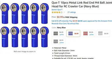

Rovan 1/5 sc buggy , I found the M4 ones in aluminum , just need the 6mm ones , I found some on McMaster-Carr for $6 each , IF I am right this will tighten up the steering significantly ? there is the carrier from the rod ends to the servo that I am not sure about ?
These might work also ???? https://www.mcmaster.com/6058K811/rod ends.png
those look the business ??
I just need M6 sizes for the rod ends , don't have to match or be pretty LOL ! Metal tight ball type
