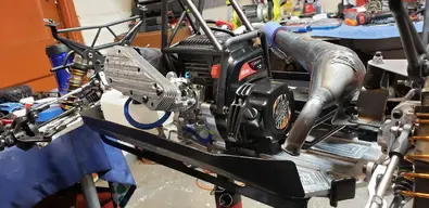

What's up fellas. Been a busy man this year with all the BS going on just like the rest of you. I feel very lucky to have this hobby to fall back on when otherwise bodem would be the case. Anyways. I have a Bartalone reedcase 45cc modified Rovan engine installed in the Losi MTXL. Check it out. Should be pretty fun. I had an OBR signature series g340 in there prior. Check it out!! 20201226_150614.jpg

looks nice mate (y),one thing though, pic 3, yer gears aint meshed,
Thanks! Good eye on the mesh. That was a pic I took mocking the engine up in the chassis deciding the thickness of the shim I needed to make for under the clutch bell carrier. Here is ready to go tomorrow pic.
hey bud nice to see a bovan (y)
im with @spents 🤷‍♂️
Sup man! I been trying to get this done. The mesh. That was a mock up pic bro. I had to fab a bunch of stuff to make this work. You know what's up.. Check this pic

I had a sparkplug to piston clearance issue during break in. It looks like the piston nipped the sparkplug just a little bit. Here are two pictures. One showing the sparkplug gap being minimal and the other down in the sparkplug hole in the head and the top of the piston. Kinda frustrating! Thoughts?

It looks like the squish wasn't set right. I wouldn't run itnlike that even if you shimmed the plug, at max rpm I bet it will still hit .Contact Bartolone, that ain't right 😬
I tried contacting Bartalone to no avail. Rovan where I bought it said contract Bartalone. Lol ya no crap. And yes I bet it needs a thicker head gasket. I am about to ship it back to Rovan for refund. I don't want to wait too long before I get an answer.
