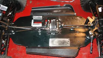

Ok well here are some pics of the buggy that I plan to install the brushless setup. The good thing is this buggy is only about 4 pounds as a roller and maybe 6 pounds with radio gear and electrics! So it's super light compared to gas 1/6 or 1/5 scales.
Here's some pics of the nitro stuff removed.
Here are some pics of a basic layout that I've been thinking about...
The first person to comment on how a toilet paper tube and some 1500 nicads won't power this buggy gets the smackdown! They are for size only. The toilet paper tube and nicads are about the same size as the motor and (2) 3s lipos I plan to run. The monster Traxxas receiver is about the same as the Hobbywing receiver that I'm looking at. That's why there is 2 receivers in these pics. The Novak receiver is about the same as the Airtronics receiver that I plan to run.
