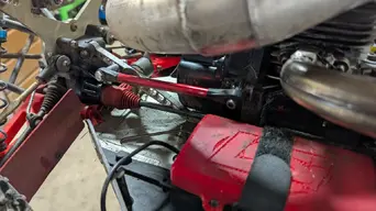

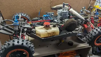

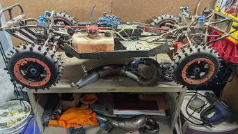

Not to hijack, but here's how I did it on a gasser to give others ideas. The rear bar bolts to the fan cover.

No worries hijacking the thread! Nice add, and since most crashes are from the front, it would definitely help.
There's a bar in the back as well, I couldn't find a good picture this morning, I just updated the post.
