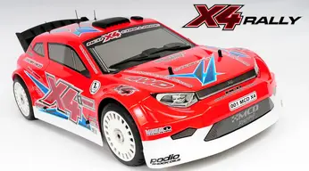

I would have to say a good start would be tires and then the body mounts from the xt. The grafil rally body would be sweet

I have been eying up that rally! I wanna get but would be something totally new. And don't really have nice smooth dirt are by me. Supose it would be killer in parking lots
