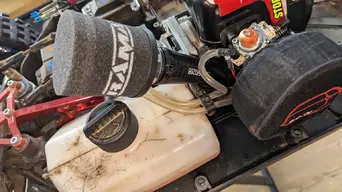

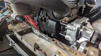

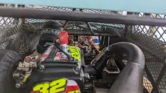

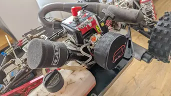

Just installed the cozmods cooling filter kit for the zen 32/34 piston ports in the five T
This is a lovely bit of kit and very well made.

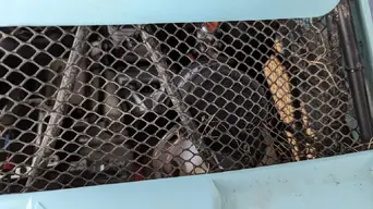

This does away with mesh mods and outercraps on the engine as it has a manifold that covers those vents.
The benefits are no grass blocking vents. Grass doesn't get sucked into the chassis. No risk of stones getting into the flywheel. Excellent cooling and at speed you are literally ramming air into the engine as the filter is in the windscreen area so it runs cooler and no loss of power from heat soak or high temperatures / overheating from the mesh mod or outercrap skirt being clogged with grass.
It's a doddle to install. Comes with everything. You will need to drop clutchbell carrier off and and clutch and clutch housing.

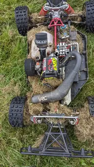

Just a follow up to show how good this mod is. After continual running in cut grass till my drive shafts were totally bound up you will see there is no grass at all near there battery tray area as the air flow from the engine fins blows it clear
