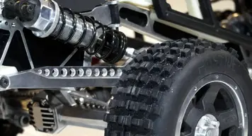

Not so far we started a new custom project. There are a lot of inspirational movies on youtube, but the most of them apply to 1/10 - 1/8 scale, so the main reason why do we start is creating something really special and interesting. One of the most unique detail is the cantilever rear suspension and straight drive train.
Final result:
Technical specification:
1) 2WD
2) Motor - Turnigy Aerodrive SK3 149KV
3) ESC - Mamba monster 6s / Ezrun MAX6 ESC (3-8S)
4) Batteries - 6s-8s LiPo
5) Chassis - aluminum milled on CNC
6) Skeleton - caprolon milled on CNC
7) Length - 810mm, width - 440mm, height - 280mm.
8) Ground clearance - min 65mm (back axle), 0-100mm (front axle).
9) Suspension travel - up to 120mm front, up to 200mm back.

If you mean how long does it take to achieve this result its better to show creation process:
1) Prototype with PVC
NqqMO4qgvoHHq2587A_D0x6HGNUZPblnEvlqli78KaFPQKGLfGi8wzvYyLcrbClZSgX3jtVBcY5UPcAjg=w1076-h1432-no.jpg
2) Produce one some of details with Caprolon
Q2wTCrRXgEIfc6VS5HgH9TVyhHfb7X9oesaezOYaQBqK6obApJxIjuH2tug8_X4BiVdwALQN2nsyefC7g=w1910-h1432-no.jpg
3) Perform tests and create first custom body
axu3ZF3Gon3wekaetqfH8FfvrR5CqJvxI89HR4wEBfEpffU6OUuEHM7z6CBHsCctxxuJWcpBdfttDLfPA=w1076-h1432-no.jpg
4)Few more tests, Assembling all the caprolon details
HHP4bXW0oMpXP8K8A-PIHJilwMNHdLu-_dXHjgZa9TAhSx84oHEfEWH6yIBu8bQ-RBNFY6bylx9xpU_w1A=w1280-h960-no.jpg
5) Moooore tests) We film couple hours of video with suspension testing on natural and experimental obstacles, motor and esc stress tests with drift, donuts, big/small wheels etc
6) Than full disassemble to pieces
n527qqyciRIyFWO2ZC0WZxfMewlvZwzi4PJB8VGsfeX_fttZ5N6MrBk4Lbl8zFc15j_ysca8oy6DiPh3g=w2048-h1363-no.jpg
7) Production first aluminum prototype
2MZNqOyZJZVAhZyodQ71Vk0ZnE5aBy7Dzm6UdegDLzUrofwJ9xO3U911nLNF4gh2EDvE9FHVg2swAwdWIww=w600-h352-no.jpg
8) Add a bit of design for final versions of arms etc
eMYt_OxHzq2Rt2Og0zobmOVlLx-2ahM6rdDq9U5Lsypb0_ULXQsrDBelkciLuUISfrpjurJKMuXWki6wg=w2048-h1297-no.jpg
9) Final check that everything fit properly
QbeK0Ubr7gqIAJBYcTqlkJRjciHm1Pz--i4UA31UpYZPvyTzOzJMC12HFSEd-4xvsn4Q_78j9NXSWw7xYg=w1339-h724-no.jpg
10) Full assemble and testing again and again on sand, mud, dirt, tarmac, gravel, city obstacles etc
So a can assume we never stop on R&D and we never stop on inventing and implementing something new in our projects.)
We are located in Moscow, Russia.
