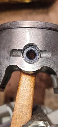

I thought I was running on the rich side and my engine died. Just wondered if this has happened to anyone else.

That is what I was thinking. It looked like machined aluminum came in from the intake. I was hoping there would have been better quality control since it was almost 800 bucks.

Does look just like it has ingested something , and I doubt it would be residual in the engine anywhere, as that would happen as soon as it was first started.

Looks like the leg broke off the clip. That will wreck an engine. The leg is supposed to be at 12 or 6 o'clock because the violent up and down motion can actually bend and work harden it until it breaks off if not positioned in line with piston travel.

i take it the engine is a taylor fella,
if the engines fairly new then email mike taylor, include some of the pics above,
especially the wrist pin clips, he may help you out with a fresh top end if it looks like a clip failure,

Looks like just a top end rebuild anyhow.
