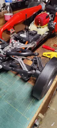

So i am building 2 hpi bajas into dragsters. But the front shock eliminator parts font fit with stock or x23 arms?

It fits with stock
I talked to jonh at detroit performance and he confirmed that dex rc had many variations of the front lowering kit non shocked. The version you have is the same as the ones on the rig in the pics of the product page on detroitperformancerc.com. they ARE different mainly the drop down after the hing pin hole. Stock arms and all aftermarket have to be modified to clear/fit the latest style detroitperformancerc reproduced since dex is done and out of the hobby.
John is sending me a set like yours for free for me to have/test along with my second bought set ( building 2 drag baja rigs)
I was sad the kraken x2e arms need alot cut out to fit and thus will not use them for that and just use extened hubs.
Good to know. I'm about to build another one. That one is about 3 years old now. So is Detroit stocking the old design as well or just old stock? If you don't mind, keep me posted on how much you had to modify. Ty!!
