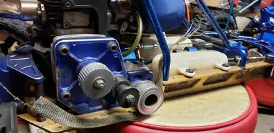

Took the DR out yesterday. Was ripping along and it stopped dead. It would rev up but wouldn't move. I suspected a broken drive belt. So I got it home to find that the belt did break. It was all jammed up between the belt cover and the brake shaft pulley which locked up all four wheels. Here are a few pics. A little pebble got stuck in the clutch bell pulley grubscrew hole. That broke the belt. Think I am putting silicone rtv down in those holes now. Some high temp automotive stuff. Thoughts?20191103_164702.webp20191103_164758.webp
