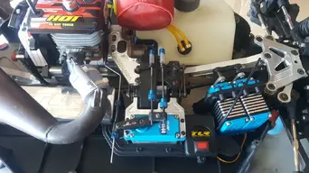

I currently have a single Hitec 845 in my 5ive T. It defenitely leaves you wanting more in the steering category. I in the process on putting all the buggy hardware in my 5ive T and going Dual steering servo. It is a simple drill and countersink task. Here is a pic of what I have so far. I should have it done in the next week. When I am finished I will have the buggy electronic tray with Dual D845 servos and the killer RC Switch mounted in the receiver box lid for easy access.
Frenimy
98
yes, I set a buggy chassis on top and bolted it down and lined everything up then drilled/marked the holes. There were less than 10 holes to drill. it took me about 30 min to drill the holes and countersink the screws on the bottom. make sure you sue a 90 degree countersink bit for the metric hardware not the 87 degree for SAE hardware.
