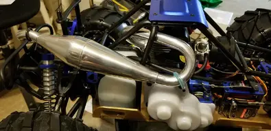

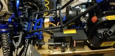

I just got back into trucks and picked up a Rampage MT V3. New to these, but not to 2 strokes in the RC world. Have been hanging out on the aviation side for many years flying giant scale gas planes, largest is 40% 170cc. All the serious builders ditch muffler gaskets and use red RTV with red loctite on the bolts. Let that cure for 24 hours and it will hold up for a good 200 flights in my experience. I have a dozen planes I've built and fly regularly so I trust the method. Just put a tuned pipe on my MT so time will tell if it will work on the ground too.

Use red rtv instead of the gasket, and red loctite on the screws. Tighten and let cure for 24 hours. My tuned pipe cracked after 3 tanks of fuel but the screws won't come loose until I take them out.
If red RTV and red Loctite works on my DLE170 mufflers, it will work on this 30cc fine too. Have been flying it for a year now, 39 flights, 5.2 hours run time, and nothing has come loose yet. lol
