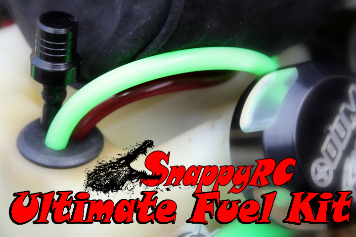

RC DAD: as a side question to this, is this kind of what the SnappyRC fuel line kit helps with?
No, the snappy kit just helps tidy up the fuel lines. It's not necessary.

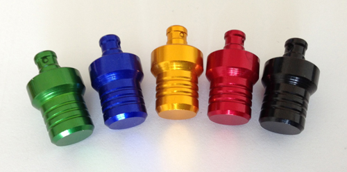

thanks for the info. mine came with one and not being a gas guy I am unsure as to what its doing exactly, in particular that end piece here:
based on there description here:
Tired of your fuel cap leaking?
Need a new grommet without purchasing a tank?
Need better ventilation for larger motors?
Solve all these problems with the SnappyRC Ultimate Fuel Kit for the HPI Baja 5B 5T and 5SC!
that is why I got the idea in my head that it would help with the fuel cap thing. But again, I really have no knowledge on this stuff so I am like a sponge right now :)
That little breather just let's air in and out of the tank. Prevents vapor lock and expansion flooding.
