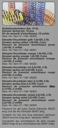

On my FG Marder, I put 2000wt in the front shocks and 3000wt in the rear. The front ones are fine but the rear seem to be slow to return to driveshafts are parallel even when using two thick (10mm) collet clips. I'm using the stock silver springs. Previously with 2000wt shock oil in the rear it would return back to where the drive shafts were parallel with the ground. Should I add a third thick collet clip or get stronger springs for the rear?
If springs, does anyone know what the FG springs ratings are for each color? Is Violet the hardest? Kinda confused because FG has Blue in front and Voilet in rear for monster models but the other way around on the buggy models.
