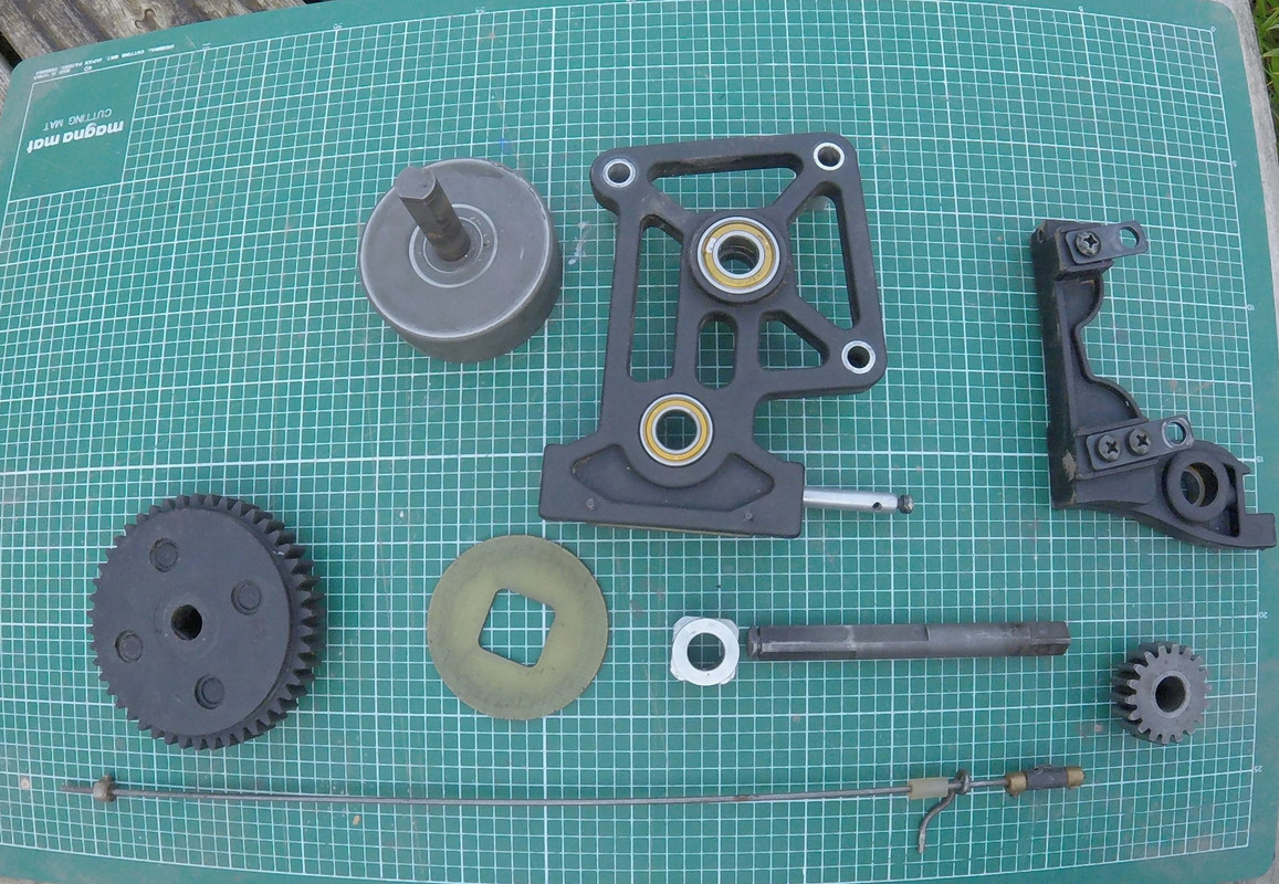

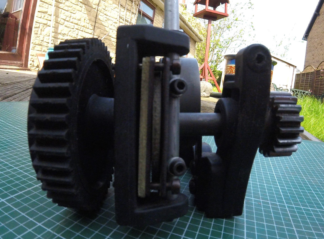

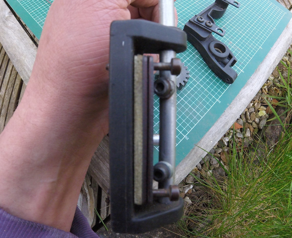

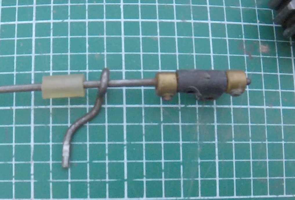

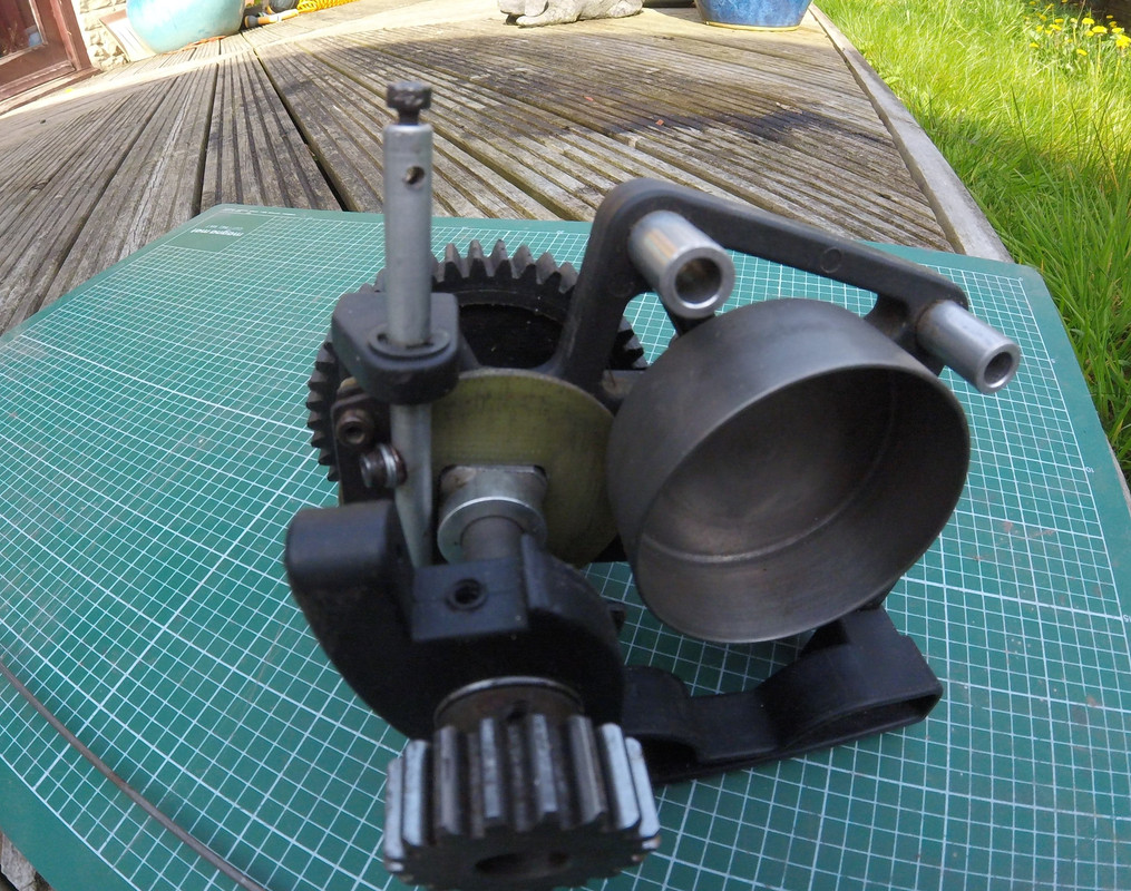

Hey guys, thanks for the tips. Here’s my brake set up now not working. Something obvious I am missing ?as clubin said, pics are usefull fella,
if i had to guess i would say if its the stock single brake it is locking on,
if thats the case then its probably the two cap head screws fg use as the brake cam, they wear a bit then over rotate and lock everything up,
new screws fitted into the brake bar usually fixes the issue![]()
looks like you are missing a spring, or piece of fuel tubing and another collar on the other side of the brake actuator lever. I haven't had an FG in many years so maybe they don't run them that way. I don't remember.Hey guys, thanks for the tips. Here’s my brake set up now not working. Something obvious I am missing ?
Wow super nice ! Thanks for the help it’s much appreciated.
you're welcome fellaWow super nice ! Thanks for the help it’s much appreciated.
