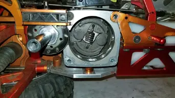

Removal of the gear plate was not as a pain as I remember. Must be thinking of the Turtle Racing HD V2 clutch assembly I have on the other two Bajas. The gear plate and clutch bell assembly I have on the King Motor is this one: https://www.rovanrc.com/product-rv85317

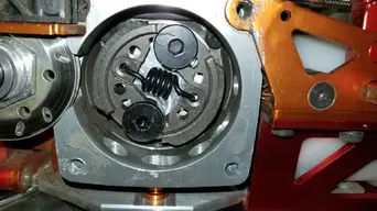

Clutch looks good. Did not see any issues here. Shoes are the same thickness as a new one. I did push some compressed air in the holes than I drilled in the gear plate. Not much if any dust came out. I did not see any signs of an engine seal leak. Clutch bell was dry as were the other parts. I would assume if there was a seal leak it would be covered in oil.
There did seem to be a repeat of the issue I discovered with the Rovan gear/clutch assembly when I tore down this vehicle after slamming the wall. The brake hex was beginning to rub against the gear plate. I will have to clean up that area of burs and may polish up the brake hex as it is galled up. Also found the lay shaft bearing slipped out against the 2nd gear shift plate. I could not get the aluminum spacer as it was too thick. Could be the 7075RC brake hex which made assembly different.

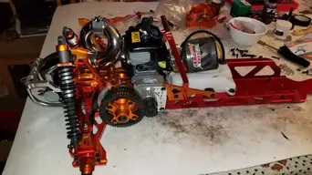

I had a few other clutches on hand. Since I was not using the Rovan 36cc engine anymore, the RCMAX clutch cooler got installed on the KM30.5cc engine. Installed new clutch and tried to reassemble the rest of the parts. No way this was going to work. Would have to start the car off the ground and drop it. Tried the other clutches even without the rear washers. Nope. Installed the original clutch mount and that worked with the original clutch assembly.
Got outside in time to get a good warm up run in. All seemed good. 2nd gear was kicking in but then it bogged down. 2nd gear was not letting go. Could not even roll the Baja with the engine off. Smoked the hell out of the clutch too. However, once I cold everything off with some compressed air, still binding. Rolled it backwards a bit and it was free to rotate forwards. :unsure:

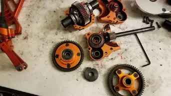

Have all the parts to ditch the 2 speed. Once I removed the decked gears it was easy to see one of the contributing issues. Layshaft was warped. The one-way bearings are installed correctly. No issue there. All of the parts move as they should when cold and or disassembled. One thing to point out, the transmission cover will get very hot when running the car. I had this issue with it before slamming the wall. This layshaft warping may have been the cause of that incident (was in a wide full throttle turn to the left but car suddenly shifted to the right and hit the wall like a magnet.
Removed the gear/clutch bell plate. Yep. the brake hex was digging in. I had it shimmed this time.
The clutch bell moves freely. No binding issues or play in the bearings that I can tell. I am not going to bother to take it apart as at this time, not going to reuse this setup.
Since I have to replace the layshaft, was a good opportunity to check for loose screws in the differential. This one is practically new. Very smooth movement on the output shafts. Before I split the case, the drive train was easy to rotate. No binding issues.
Perhaps the one-way bearings are not rated for the RPM range. The extended layshaft is prone to warping. Gear mesh issues and full lockup when 2nd gear is engaged. It was not just the clutch that was smoking, the transmission case was too hot to touch without getting burned. Just not worth the headache. Another Novelty thing. I never had any issues with the two speeds in the 1/10 scale platform. Still have the two. Hard to believe they are 22+ years old.
