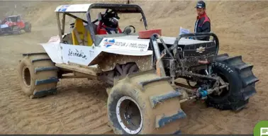

This is the inspiration

They need a 1/5 4x4 2 stroke version of that. The engine looks like it would sit right in the cab.
They do make a petrol version of this, known as the FS Buggy. They are copies of the Reely Carbon Fighter.

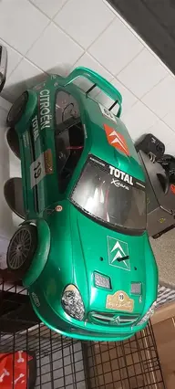

Dude sorry I know this is an old post, but iv just gotten my x5 back out of the loft, I'd converted mine to a 1/5 Citroën xsara rally car, looking for "inspiration" and came across this, so with yours and mine being converted I had to comment lol, I'm now thinking about putting a max 6 combo in and running 8s
