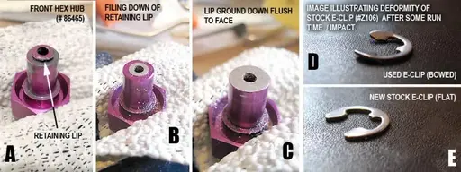

Some of you may know about this mod or not. feed up of losing your front wheels due to that like c-clip that holds it on well here a mod for you.
another great no c clip mod is to take an old set of rear outter drive cups (wheel side) and grind the cup off, and continute to grind the cup back plate (T piece on the axle left after you cut the cup sides off) and shape it like a thin button head bolt. this will allow it clearance around the pivot ball and front arm area.
then slide it in place and use a rear hex to secure or a rear extender to get a bit wider front width.
not to take anything from the bolt mod. i still use it on one baja, but when i wear out another set of drive cups, which will be soon by the looks of it, lol, the 2nd one is getting it. both are great mods, though in the long run, i think the modded cup mod does a lil better job of it.
