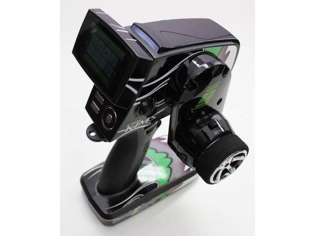

It's called Radiopost. I bought it from a brick and mortar for a hundred bucks.
Not too long ago, a radio like this would have been a thousand.
