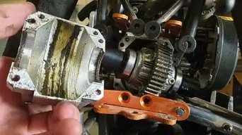

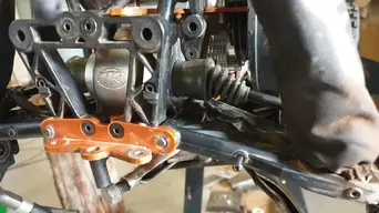

Hey Doug, do those irc diff housings come with their own shape gasket or are they same as stock shape? Getting really annoyed over here as my stock diff keeps leaking without any use. It's drained itself twice so far sitting on the shelf. New Rovan gasket if that even means anything.
The IRC diffs have their own gaskets mate. ??Hey Doug, do those irc diff housings come with their own shape gasket or are they same as stock shape? Getting really annoyed over here as my stock diff keeps leaking without any use. It's drained itself twice so far sitting on the shelf. New Rovan gasket if that even means anything.
Yes that's what I was wondering. Thanks. But now that Z mentioned the inner bearings/seals, that looks to be where it's leaking from. So idk now, rovan parts or do I have other options?The IRC diffs have their own gaskets mate. ??
Rovan has the seals, and the bearing size can be found in the manual. Although, I would replace them with bushings as the bearings always seem to explode. Irc makes them for their own case but will fit any other case. If they are out of stock, HSP/Redcat/exceed make bushings (the size is 15x10x4Yes that's what I was wondering. Thanks. But now that Z mentioned the inner bearings/seals, that looks to be where it's leaking from. So idk now, rovan parts or do I have other options?
