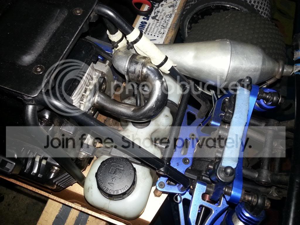

Okay, I'll give photo bucket a go, have an old account I can use. I've fitted the pipe in two ways. I have two identical HSP buggies, sold as redcat TT-5's.
Minor twist to header, and clipped to the rear shock bolt

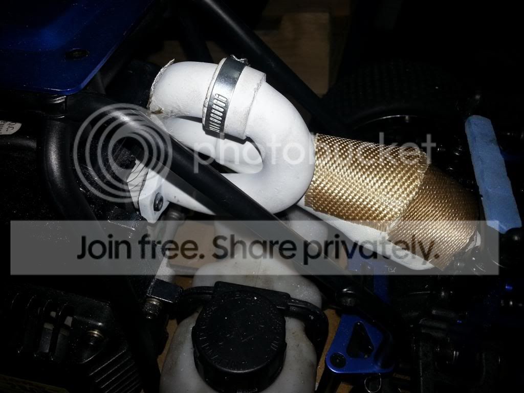

Little more work with exit within the shock plate using stock clip. Used a little heat shield material on the pipe ue to proximity to body.

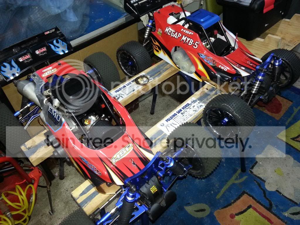

The two buggys below.....
