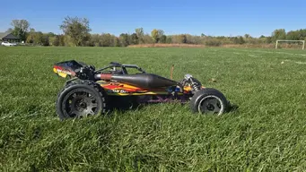

And now I need a wheelie bar. Decided to try some Badlands MX57s and it's excellent, even with a 20T pinion (19T drive). Was surprised to find that it now does wheelies mid-run, which I assume is because the revs arr hanging more in the peak power RPMs instead of going past. I'm going to try a 19T once DDM gets them back in stock, as I feel that will be the sweet spot.
Anyone else done something like this? If so, how did it go and which wheels/tires did you use?
It works really well with the G320 powerband. DDM finally got the 19t pinions in stock. Will try that soon. I'm thinking it will be the sweet spot.

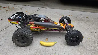

As an update on this: I'm now running the MadMax Giant Grips on the front. Adds more front grip, looks better with the rears, and adds just enough weight to keep the nose down.
P.S It peaks at ~53mph on grass with 19t pinion. With street tires in same rear size it does ~67mph with the same.

Did another set of runs with cooler temperatures and retorqued exhaust manifold.
Top speed: 73.16mph
0-60: 3.69s
