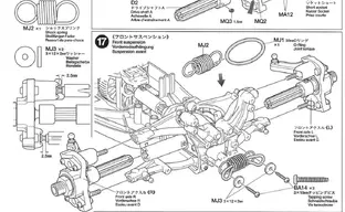

does anyone know what this horizontal shock spring with o-ring going through it actually does?
the front bumper goes over it but what's the purpose of the spring & o-ring?
i found this pic from another forum and even the owner of it didn't know the spring/o-ring purpose.
maybe it's for the front bumper when it impacts..it's weird.
Looks to me like those shock uprights pivot and the spring is involved somehow. There is a zig zag separation in the center by the looks of it.
thanks mate you're right, i took a closer look and the shock tower is 2 piece with the zig zag join and i guess the spring & o-ring acts like a tensioner for it.
i have the spring but missing the o-ring...it's odd for sure.
Tamiya must of thought if the front hits something hard enough the 2 piece shock tower would open a bit to stop it from breaking? like a servo saver post.
Kinda my thoughts too, but it also appears to be bolted top and bottom on each side, so why not make it one piece? Ive been scouring the web and can't find mention of it. I'm really curious.
