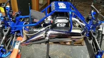

Yes the air filtration is much better using the hpi baja filter. One of the biggest things to get the inner filter sealed is putting a thin layer of synthetic grease on the base of the inner filter so when it is slid on the filter housing it seals at the base. Then put an outerwares on the outside. Also I use an angled shred stack from ddm racing to tilt the filter housing up a little bit for ease of access
i...just don't understand what im a seeing???....angle shred...is it really necessary??
20170428_212223.webpSee the air filter? The angled shred stack is what the filter clips to. The shred tilts up the filter for ease of replacing the filter and helps keep the filter from hitting the linkage. Necessary? ? Man I don't know I thought it would be useful. The clip can be a pain with it tilted. Then a bit of a hard time getting the outerwears on etc. Your choice man..
