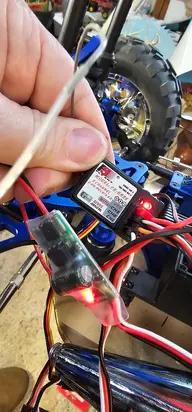

I installed a better kill switch on my 1/5 scale Rampage MT. My other one burned in half for some odd reason. I replaced the on/off switch on the truck and also the kill switch button. I turn truck on first and then transmitter. Blue and red lights come on and then blue goes out and red stays on meaning kill switch is activated so truck won't start. Any ideas? I'm getting so aggravated because I can't run my truck. Any help would be appreciated!

Turn transmitter on first...... always.......then you should have a button/switch to check kill switch function. Usally a steady light to run,blinking shows kill switch operating. Check for spark to help determine if kill switch on.
Thanks. I tried that but same problem:/ I'm not sure what to do. It seems kill switch is activated but staying on so will not start not getting any spark
