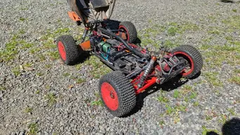

Here's the RC these shocks are actually going on. A heavily modified Dbxle
