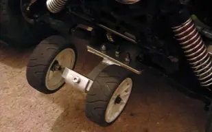

Here is my new Wheelie bar that I bought from the Market place here. I found I needed to reinstall the rear bar so that the wheelie bar had something to push back against and not bend the chassis. It has some sort of rubber flex deal in the center that allows the bar to flex slightly up and down to take out the chance of bending but, it also will push against the rear bar if there is too much force. I will get a chance to try it out once it stops raining.:boat:
I thought I would start off with a photo of mine and add the others I have seen in my wheelie bar quest. Add yours please! The more ideas the better for us all to ponder over.:)

Yes it is. I have found that you will need one that has some type of support in the rear that will not allow the rear chassis to flex or bend.
The cheapest way from what I hear is to buy some parts from FG and some alluminum rod and make your own.
Needed for this setup:
2 pack fg part number 7021.
8mm aluminum rod, you can get them from any hardware.
Use any wheel you would like.

I know this is kinda simple but man it works reallly good.And its tough no flex and not going to break.I made this for doing some strait line sand/street dragging.All hand made by a Carpender lol.

Here's mine. Wasn't hard to make and it raised the diff up about 3/16 of an inch. I just drilled some angle to match the holes in the rear end of the chassis, and added an old skateboard wheel that my son had lying around with a bolt for an axle. Works pretty good and keeps me from denting up my pipe.

Nice job.:cool2: Like how the add stiffens the rear. What was the reason to add the second aluminum dowel in the 2nd photo?
Just to add some side to side strength. The second pic is what I'm running now, the first and third was the first attempt. I used a thinner angle and it bent on impact from a bad landing. I switched it over to 3/16" and haven't had a problem since.:)
