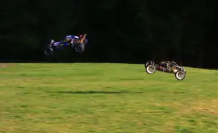

I have raced the Rally car on road for over 18 months but it's simply not as enjoyable as bashing it off road.
The only thing I broke using it off road was a plastic shock fork and that was a result of a high speed landing off one of the jumps at the motocross track.
The tyres don't provide the same traction as a conventional off road tyre but that means it's great for drifting especially on very short grass or dirt.
A few more photos of it at the local 1/8th track -
