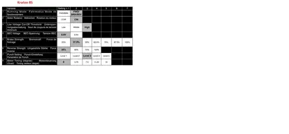

I had some troubles with my new dbxle-2.0 version. horizon hobby send me a brand new ESC to replace my existing one. The one that was on my car did not have any capacitors attached to the cables and the NEW one that horizon send me it does have it. I did some research and found out the ESC with capacitors comes on the Kraton 8S.
I spoke to tech support and he said the one with capacitors is better and i can use it on my DBXLE-2.0.
My concern is that if i use the NEW ESC on my DBXLE-2.0 I will have the Kratos 8S ESC functions/Mode instead of the Losi DBXLE-2.0 Modes.

DBXLE-2.0 ESC Function/Modes
Kraton 8S ESC Function/Mods

I would ask for a programming card from them so you can easily change esc settings If they can’t supply you with a correct esc.
as it looks like the below will need to be changed.
the motor rotation is reversed on the crayton so this will need to be changed in the esc settings or x2 motor wire swapping over as when you calibrate it for the first time it will go backwards when you accelerate.
the bec voltage for the steering servo is set to 6.0v on the carton and should be 8.4v for the Losi.
the punch is at 3 on the craton and 4 for the lose. This might not make to much difference as there is so much torque anyway with the 1/5 motors.
you can probably do all this manually with the on/off switch but this can get messy if you haven done this before.

niz55
20
The new esc has the same exact programming as my dbxle 2.0. for some odd reason the kraton with the same esc has different programming.
Anyways the esc worked great.
I believe the RTR kits are programmed differently from the manufacturer like the kraton 8S but when you buy a new esc it comes with its own programming.
Here is the programming on the new esc.
Picture from the esc manual.
