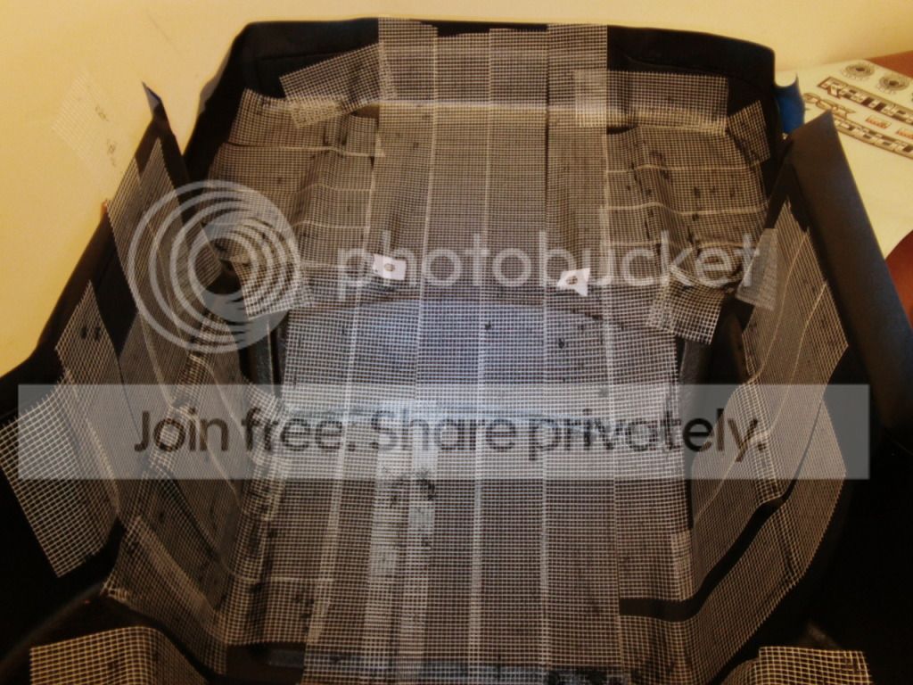

Shoe Goo and drywall mesh tape works better. The fiberglass will be to brittle. It is good to have some flex to absorb impack.
You got a system under that body? Haha. I bet that's heavier then the shoe goo method but if it keeps the body together, that's awsome
This works wonders as well.
I recently did fiberglass and resin on my XT body and it didn't melt anything and bonded great. However like stated above its rock solid, no flex. I like it solid so it's a matter of opinion I guess..

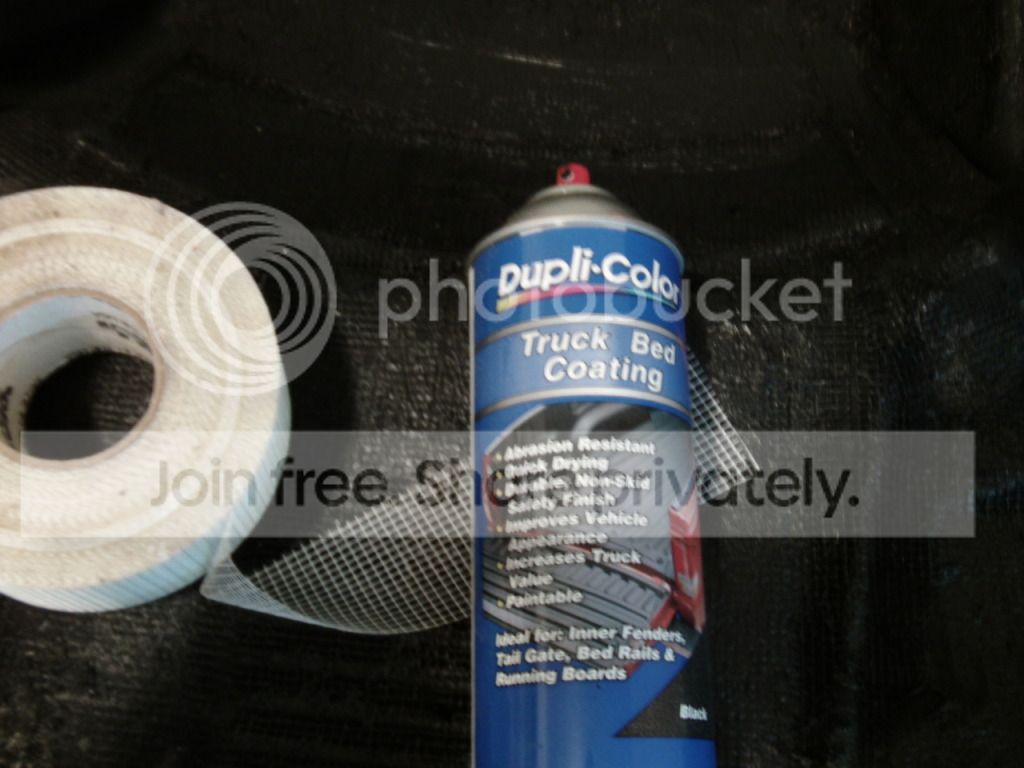

I recently did my mini savage body....I did mesh tape, then plastic spray then shoo goo.
I will reverse it on next body and do mesh tape shoo goo then plastic spray (or bed liner) the liner/plastic spray seems to lift the mesh tape away from the body. the shoo goo will keeep it in place first......
fiberglass will make it more solid, but I believe the shoo goo / mesh tape / plastic dip spray or truck bed liner is the best body re-enforcement you can do!!!!
