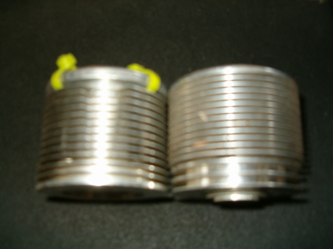

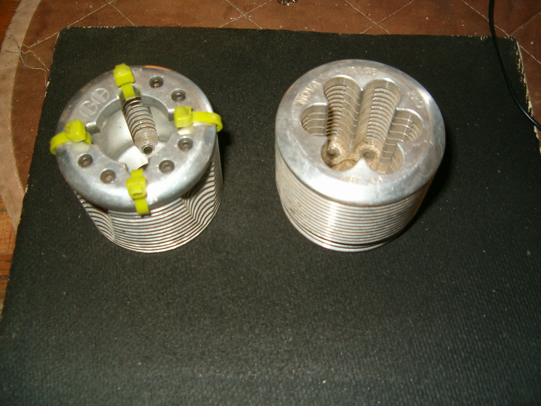

If I remember right ,in the application ,it was about the cooling ,not the strength ,the debate was over which one cooled better!
However ,in my experience ,it doesn't matter ,the aluminum stays hot as long as the heat source is still active ,the aluminum heats
up faster an stays hot until the heat is turned off ,then when the heat is off ,the aluminum cools faster!
Here is a couple of old Nova racing heads that I have ,the only reason that I have them ,is they looked cool .an at that time
period ,everyone was wanting & getting them ,so I jumped on the wagon ,however ,the head did feel cooler than the original!
