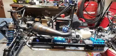

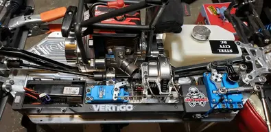

Not sure what engine you have. But I used a Losi 5iveB quick release linkage for a reed engine on mine. Fit very well. That is my truck someone linked above to my YouTube channel. Here are a few pics of the setup. Totally eliminates the pivot arm and reverses the brake operation. The brakes will work either way. Pushed or pulled. 20191215_172601.webp20191215_173904.webp20190222_093915.webp
