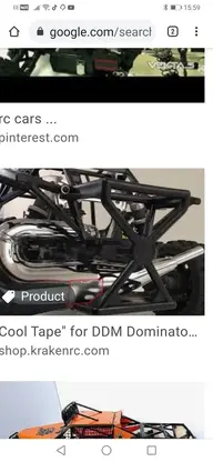

The exhaust chamber goes through the bottom of the cage part, you don't put the header through, hard to explain I'll see if I can find a pic
Here ☝🏻 it looks like you need a piece of "cool tape" to stop the cage from melting too😁
From the looks of it you have to mount the pipe to the buggy then mount the bumper or move them into place at the same time.
