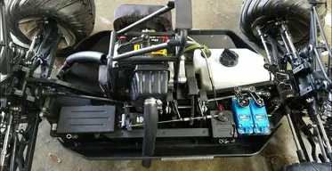

I am going to the LHS to get the MTXL next weekend. I have two Hitec D845 servos for steering, Futaba rx and a 2s lipo. Hot racing servo saver assy. Which throttle servo do you guys use? Thanks
I still have my factory one, I don't see a need really to upgrade it. It could be a little faster, but id rather put my money towards a pipe. I have the d845 servos and it is a huge step up. You will need a 3mm spacer though as they are a little taller. I just went to my local hardware store and got a 1/4" aluminum spacer. Worked perfect received_2344446588914470.webp received_2357217020970760.webp
I still have my factory one, I don't see a need really to upgrade it. It could be a little faster, but id rather put my money towards a pipe. I have the d845 servos and it is a huge step up. You will need a 3mm spacer though as they are a little taller. I just went to my local hardware store and got a 1/4" aluminum spacer. Worked perfect View attachment 45069 View attachment 45071
Nice Man. Is there any issues getting the two servos to sync together? I already have my eyeballs on a Bartalone pipe too. Thanks for the input
Zero issues, just have to center them first by turning on your truck before you put the horns on. That's basically it, I was looking at the bartalone as there name is really out there, but after hearing a few jetpro pipes I really like the sound of those better. Just my opinion though.
