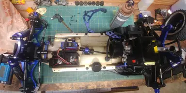

Here she is. All cleaned up

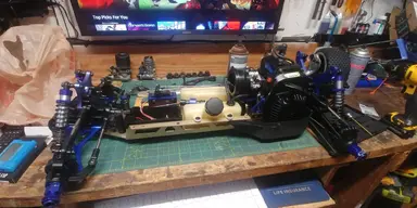

Nice! Here's a peek at a custom MT I've been working on the past few months. Awaiting my motor from OBR is all that's left.
