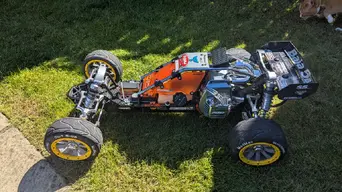

Using the higher octane version of fuel, such as V-Power, or Premium 99 - has the distinct advantages of a) containing less ethanol and b) has detergents for keeping engines cleaner. I only use this fuel for my Baja 5B. Not for performance necessarily, but for longevity.
25:1 is often the recommendation for 2 stroke and in my experience this is far too oily.
32:1 is a much better choice on decent 2 stroke oil. I use Silkolene Pro 2.
My Baja 5B on 18 year old CY Fuelie 26cc Engine:
0-40mph:
Whilst this is purely my personal preference/opinion, I believe my experience and results lend some weight to it. My engine porting experience is limited to nitro and whilst I have improved my CY engine, I haven't attacked it with a Dremel (yet!). 😅
It's still good for 19300rpm. Part of this surprising longevity I put down to the 'right' fuel choices.
