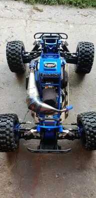

I have a Redcat Rampage MT Pro 32cc. I have a tuned pipe that runs near the body on the right rear quarter. I have heat tape, but not sure if I need to tape the inside body or not. What do all of you think? I can provide picture for viewing if needed. Thanks Ahead!
Thanks for the response Phil! Here is a picture with the body next to it. , How hot do the pipes get? F6F71706-761C-4D0F-8F9E-6246B4EA53CD.webp
They get extremely hot.
Will definitely melt the body there.
Is that pipe alloy?
If so it won't last long.
You'd be better off spending the extra on a steel one.
I think it’s alloy, it has a shiny aluminum look. Thanks, I’m all ears...LOL. what brand are the pipes that come out the side?
I have a Dune Runner with a Jetpro rear mount and silencer on it and it's great.
You may need a silencer depending on where you're running it.

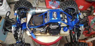

Ya the body melts a little. But like Phill said. The stock pro pipe is aluminum and will crack. There are a few choices for the MT. DDM Racing makes a side mount pipe called the Dominator. I had that on my MT a few years. Jetpro also makes a side mount and rear mount. Now recently Olimat makes a pipe that fits under the body. I put the Olimat on recently. Here are a few pics20190720_181442.webp20190720_175654.webp
Ya the body melts a little. But like Phill said. The stock pro pipe is aluminum and will crack. There are a few choices for the MT. DDM Racing makes a side mount pipe called the Dominator. I had that on my MT a few years. Jetpro also makes a side mount and rear mount. Now recently Olimat makes a pipe that fits under the body. I put the Olimat on recently. Here are a few picsView attachment 14561View attachment 14563
The more I look at that pipe the bigger it gets.:eek:
