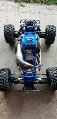

Appreciate you checking out my channel RC brother! Thanks for the kind words man. That MT is a really fun truck once all the kinks are out of it. Mine is ready for a tear down. First time it has really failed me in quite some time. Something came loose in the belt system or the clutch is smoked. Now the key. Finding the time lol.20190720_181442.webp
What pipe do you have on, I tried looking for one of those and can't find them, I know what you mean with the time lol, all I do is work myself, I just going to keep buying parts and do it all at one time,
Work.,....man, that’s the truth! All the people on here got me setup and going with my pipe, setup and Rampage Mt V3 break in over the summer. It was hot but boy was it fun!!!!! 47B47E69-5181-4EAA-82E4-53E582D26693.webp
