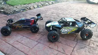

Ol' fart came through for this Canuck. Awesome motor mount. Had to move the centre diff 4mm back to fit in the massive Leopard 58110 motor. Juuuuust fits now. This thing honks. Test run showed 103kms/hr. Unfortunately blew out the rear tire foam on the third pass...lol...Gotta get some more of those, just in case. Motor and xlx both run at a decent temp. Was running 16t with stock 41t. just ordered an 18T to see what this puppy will do.

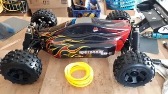

I've got these electrics ready and waiting for when the motor and servo mounts i bought from ol' fart arrive. I'll be getting the servo saver and front and rear bearing carriers this time also.

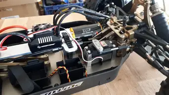

- Hobbywing Max6
- TP 5660 848kv
- Hitec 5765
Now to the nitty gritty
TP 5660 850kv
HW Max6
Hitec 5765

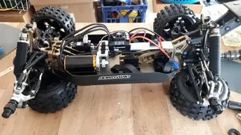

7075rc Servo mount, motor mount, 44T spur, 15T pinion (and a 16T) front/rear hubs
2x NXE 7400mah 4S HV lipos. Awesome batteries and cheap(ish)
I'm running 2x front chassis braces and Baja 5b rear wheels all round, on 8S HV lipos. There's quite a bit less flex in the front so that mod payed off :)
Just need to fix up the wiring and install the yellow beadlocks

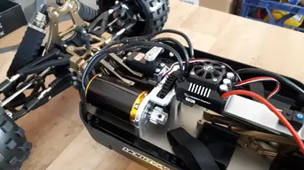

Ok I went ahead and bought a "build your own" TP4060, 990kv, 8mm shaft from TP USA. I also got the Losi 11 and 12T 8mm bore pinions. This the cheaper and far better option in my opinion. No need for 7075rc motor mount and a big heavy Leo 56 or 58 can motor, the TP has 6200watt of power compared to a Leo 5898 at only 5500watt anyway (y) Plus 121amp draw on 8S which the HW Max6 won't break a sweat with, even running the Baja 5B fronts all round....it's a winner for sure.
I'll post back my findings once I get the motor
Here's a pic in it's current state. I certainly recommend the Redcat alloy shock towers, much beefier than the stock rubbish
What mount are you using on the motor? Is it the stock one??
