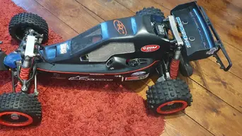

Pics pics pics please I hate grass I haven't even mesh nodded my crankcase yet just the pullstart I'm trying to find a way to stop grass getting in my Baja without taking my engine out last resort is araldite and mesh or outerwears but I want a way to keep grass out of the chasis engine area

did you have to mess with roll cage for that body to fit ? It looks like it would work great in winter to ice race on lake and with all windows and scoop vents closed up it would hold a little heat in when 10 degrees out....
That's an interesting idea, I'd like to see temp reading with and without it. Your losing a ton of surface area installing it. But it would deffinatly keep your engine cleaner. The only real concern I would have is the filter is right there at rear wheel on a baja could easily fill it full of crud.

I did this hopefully it helps I've meshed the pullstart inside and out and meshed the gaps on the chasis between the main chasis and engine fan cover and also on the clutch bell holder also obviously the crankcase is mesh modded also
