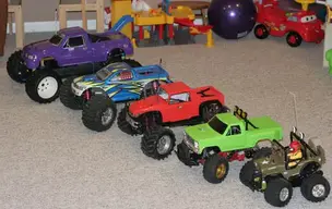

I got the Firehammer MT today! I came home early from work because of an errand and it arrived about 5 minutes after I walked in the door.
Love it! My 19 month old decided to climb on the back and sit on it. Wife told him to get down because she didn't want him to break it! LOL.
Of all the colors, I got purple, but for the price I got it for brand new, I'm not going to complain. I'll get a clear body eventually! Maybe I can put "prince" on the license plate.
I'll post some pics later or at least somewhere they can be viewed! I'm pretty pumped up about it.

Anyway, attached is a pic of my truck with my other trucks. Thanks everyone for all your help! Expect more questions sometime soon.

Its too clean its too clean!!!!:clown:

At least you didn't say "it's too purple, it's too purple"! :)
